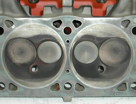

I have the chance (don't know about the energy though :? ) to do another dyno test of Singh grooves on a SB Mopar engine. I'm wondering if someone could run CFD analysis of the cylinder head groove since it seems to me groove placement so far has been a "best guess" approach, so I wonder if CFD run would help with groove placement.
Do you want the groove to stir up the hottest or coldest part of the chamber? Where does detonation start the hottest part of the chamber or the coldest? Or both?
If I do this test it would be very similar to that last one but with the addition of steady state tests, both WOT and part throttle, and at various RPMs to nail down more accurate BSFC numbers. One other thing I'd like to try is run the octane down to actual detonation without grooves to test if the grooves supress detonation on the dyno.
Further ideas or comments might be appreciated.

Can you post a picture of the piston and chamber? I will try to model it, I haven't done moving parts yet, so I'm not sure how to do it yet.

The engine is 4.030 bore, 4.000 stroke, with iron RHS/Protopline 360-HPST heads, CR 10.8 without any chamber or piston dish work.
Here is a picture of a stock Magnum chamber. The RHS/Protopline 360-HPST chamber is very close if not exactly the same.
The first engine I tested grooves on had flat top pistons KB-107, these are right/left pistons with specific exhaust and intake valve reliefs.
The pistons in the second proposed test engine are a CP dished version, I don't have one available right now to take a picture. The dish does not match the chamber exactly so I was planning to do some chamber work to match the piston's dish and also to lower the CR some to help ensure it would run on pump gas.
How exact do you want to be?
One thing I'm wondering about is where the groove/grooves should be "aimed".
Theory (as I understand it) is that the grooves act both as mixing jet for the chamber and a fuse to light the quench area mixture.
So should there be one or more grooves?
Aimed at the sparkplug or intake/exhaust valves. or some combination of these?
If all the grooves accomplish is lower the octane requirement of the engine that alone is a big plus in a 90% street engine.

Postby Unkl Ian » Tue Mar 20, 2007 8:39 pm
How much time have you got to do the testing ?
One possibility is to test one groove,then retest with more grooves.

Postby Windsor377 » Tue Mar 20, 2007 9:14 pm
I can only reference the recommendations AB gave when asked for best groove positioning. Usually the answwer was 2 grooves. one on the plug side aimed at the plug and one opposite also aimed at the plug.

Postby mpgmike » Tue Mar 20, 2007 11:59 pm
I found a tad better luck aiming the groove to the exhaust side of the plug. Split the middle of the heart and have the groove pointing to the threads on the exhaust side of the plug. Run it back to just short (0.040" or so) of the gasket. A single groove will show you some results you want. You shouldn't have to worry about lowering compression ratio either. Matching pistons to CC is a different issue, though.

I find it interesting, mpgmike talks of aiming a squish jet to the exhaust side of the plug and Larry Widmer describes a “pulse wave/squish and aiming it to the flame kernel”. Many photographs of the flame kernel in early stages show development at the exhaust side of the plug where many people consider to be an ideal location for flame growth.
I sent Larry a message maybe he will tune in?

Larry Widmer on PM wrote:There were a number of us who fooled with trenches and chamber/quench pad "fixes" in the late 70's and early 80's in some race programs that were well-financed enough to permit extensive dyno and track back-to-back testing. With the exception of some small improvements in RPM ranges far below anything we were running in competition, we saw no gains whatever...in fact, in most situations, we saw slight losses, even with lots of tuning time.
My thoughts on the grooves run something like this....if you have an engine that utilizes a relatively antiquated combustion chamber and piston design, it may help, especially in the lower RPM ranges, but don't expect to see them on our Honda's or other 4-valvers anytime soon!

Grooves in the heads only, , what are you thinking?? :D
I don't think I will have the energy to pull the heads more than one time, pulling the heads more than one time will run the testing into two days and I don't want to do that.
I'll be recording engine knock, I'm trying to get my son to build the setup to do that. I mean he's gonna get a bad case of blood clots from deep-dead butt thrombosis if I don't get him away from hours of dumb computer games.
I'm wondering if aiming the grooves directly at the plug is the wrong thing to do. I wonder if it can disrupt the flame kernel and travel, maybe that is why the grooves actually lost a bit of power in the higher RPM tests last time.

I was just thinking that pistons are cheaper then cylinder heads,
if you needed to undo the groove modification.
If you were running(pick a number) let's say 30 degrees ignition advance,how far could the flame kernal develop before the quench effect
started to take place ? Probably a fair amount.
I'd suggest starting your tests at as low an rpm as possible.
That might be where the "benefits" are seen.
Compare torque,and detonation resistance.

putztastics wrote:I have the chance (don't know about the energy though:? ) to do another
or the coldest? Or both?.....
Going back to the original query regarding groove placement my approach
has been get as many possibilities that I can come up with out there and
see if I can figure out what works best.
Most of my experience has been with the single groove pointing at the
plug. This has work out very well with no problems encountered. I have
over thirty engines running with this layout including N/A, NOs and blown
applications. My thoughts on pointing the “jet” at the plug is IF the jet
forms a concentrated stream that reaches the plug it does so too late in
the cycle to quench the flame kernel. I make this conclusion because with
the engines I have done all have reduced misfire tendencies.
Several of the EFI engines I did with a single groove were tuned on a
chassis dyno. I suggested reduced ignition advance thinking the
requirements would be less than normal. In all cases the engine lost power
with less ignition advance. Much to my surprise with 2 degrees more
advance than normal for these engines an additional 20 -25 RWHP was
recorded. I can only guess these engines normally run on a knock sensor
and the modification allowed more advance? Two of these engines have a
more modern LSx combustion chamber.
With NHRA’s relaxed rules on combustion chamber modification several
Super Stock racers have approached me about the modification. I had a
long discussion with Wesley Roberson, division four tech. His response
was they would change the configuration of the chamber making them
illegal.
I did several engines with a multiple parallel grove layout. The engines are
performing well, I can’t say if this is an improvement, perhaps more time
will tell.
Lately I have been trying “converging grooves”. This idea was the thinking
of “Silverback” from the Maryland area. First indications are good but
more time is needed to determine if this provides additional benefits.
Here are three basic layouts I use for the wedge head:
