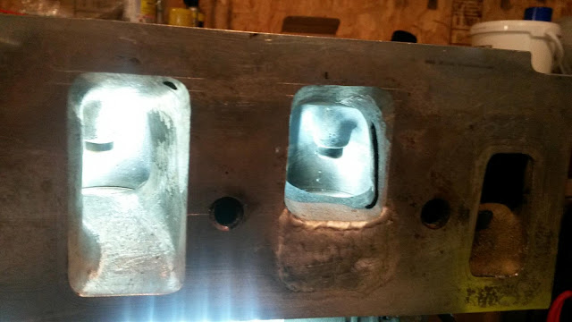

When all the welding is done and before any machining is done I would ship those out to get a Cryogenic treatment done on them!

I assumed pretty much every surface would have to be gone over and corrected but checking with a straight edge and feeler gauges nothing is moving around too much it seems. I was going to use threaded inserts everywhere in these heads - a few holes were stripped already when I got them (they are used, I didn't have the balls to do this on brand new castings!). The one thing I think I will do is make rigid steel inserts for the bolt holes. I know that most guys don't bother with that on these castings but with this much welding I think it would be prudent.

I am glad your dimensions are not moving much. I once did a double two barrel tbi intake top for a crossfire intake that I ported and the top shrank a huge amount.

I just went over everything again and the deck surface is out about 0.004" end to end (curved up at the edges). Everything else won't even let a straightedge wobble.

Getting this torch in there is doable now. Pulled the teflon insulator, cut down the ceramic cup with a diamond wheel on the lathe, and turned down the back cap to be nothing more than a brass button with an insulator on it (the last part isn't shown in this picture). The torch will now physically fit inside the runner and get good angle on the lower corners behind the pushrod pinches.
The biggest issue is keeping good torch angle and also having a place to stick the filler rod *if* I can see the puddle. I may do the short turn apex by sticking the torch in the port and adding filler rod from the throat. Once you start getting into this stuff I realize how hard it is to do what Jody Collier does on Youtube (weldingtipsandtricks) with a camera always in the way. I'm thinking I might be able to adapt a short Pyrex gas lens setup to this torch, that may help to see things.
I am pretty sure John Marcella uses a 9/24 size torch for this sort of thing based on the videos Miller has on their Youtube channel featuring The Man; I'm trying to get close without having to buy a third torch.

Alright got some torch time today. I've got a #24 torch on the way - it'll get me another half inch shorter and still has a higher duty cycle than my TIG machine. I'm going to get them all roughed like this and then whenever Chad gets back to the port roughing I'll get some measurements to make sure I've got enough height for him before shipping.
For reference the short turn is only about 0.100" taller there, but I needed to get in there and smooth everything out for a finish pass anyways.

One more done. What a stupid idea this was!

Someone on an Oldsmobile forum asked for the CSA measurements as they stand now so I thought I'd capture them here as well for posterity (all are approximate, I'm not great with snap gauges but got consistent readings):
Port Entrance - 1.75" H x 1.4" W for 2.45in^2
2" in - 1.65" H x 1.65" W (1.45" W at bolt pinch on inner port) for 2.72in^2 (2.39in^2 inner)
At SSR Apex - 1.6"ish H x 1.75" W for 2.8in^2
The port entrance roof is 0.625" Down from the top of the valve cover rail, and the port entrance floor is 1.43" up from the deck surface. So I raised the port entrances almost exactly one inch. Pipemax says 2.93" CSA would be ideal, I'm interested to see what Chad comes up with. Bigger over the SSR will slow the air down, and I think I want to be on the low side of 300-315fps? Again, interested to know what Chad thinks.
Keep in mind I'm not porting these, just sticking filler in there so Speier has room to really explore the area.
I'm interested to know what to do behind the pushrod sleeves that will go in there. Should I build up a ramp or leave it alone and the porting will account for the dead space behind the tubes?
