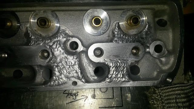

Rick Finsta wrote:I need to raise those spring seats - what is the best way to get those guides out of there? Then I can turn a stainless or copper bar in the lathe that will be a light slip fit and I can weld up around them.
I'm not saying this is the right way, there's probably a lot, but I've used an oven and a press to remove valve guides on aluminum heads. Heat the heads up to 275-300 and they come out fairly easily. You have to make sure you've got the guide perfectly in line with your press though, so it's a bit sketchy.
I also tried a drift and a hammer on a set of aluminum heads that I wasn't planning on doing with, just to see how it would work (hey, I get bored sometimes). With no heat and a drift I was able to hammer the guides out without damaging the heads. I was surprised. That was a Ford DOHC "C" head with 16 valve guides, and they all came out. Mind you, I didn't try to get the guides out with the first blow, I just kind of tapped them with my hammer (I think it's a 16 oz ball peen that I used). I just started tapping on them until I found the force that was needed to get it to start moving and continued with that force. I imagine that's an ok method for removing them, but I certainly wouldn't try to install them that way.

*, I'm thinking on how to raise the spring seats and would appreciate your feedback. I think I want to make 0.375" thick aluminum spacers on the lathe, with a full depth chamfer, and I'll make a tool that will pilot on the guide and make a matching chamfer on the head. Then I'll weld around the periphery with the guides in place.
Would 0.375" of aluminum spring seat plus whatever is below it in your port support 220/550lb springs?

Before you raise those spring seats do you have extra long valves and spring combo worked out? That also screws with your geometry. I would hate to see more work done that can't be made to run. Thanks, Charlie

Valves are very likely going to be custom and Jesel or T&D are going to have to work out the geometry! Absolute worst case I can weld up the rocker pads and cut new locations.

Finally got back to these after building a new fuel tank. Just a little more work on the top and then I get to the real PITA which is the runners. *, we'll need to figure out how to work the logistics on this. I'm not sure if you want to send the first head back to me so I can get everything welded to where you'll need it, or if we'll need to go back and forth with shipping a few times.
I've got some carbon (graphite) rod on the way to plug up the pushrod and head bolt holes while I weld up the port you've got roughed in, and for the valve guide holes as well.

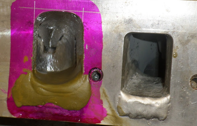

Got the last bit done on the top of the head and started hacking at the runners for more torch clearance. I just raised it 0.250" and looks like * took nearly 0.500" out up there; I don't want to get anywhere near where he needs to be shaping things so I don't have to repair little divots here and there later on, but another few tenths would really help me hit that short turn with the torch. I also opened up the pushrod pinches a little to be able to get around them more easily with the torch.
Here's the stock height for reference:
*, you've got prettier dykem than I do. Jealous.
I've got the graphite rod to plug up areas I don't want weld to go (like the valve guide holes, bolt holes, pushrod holes) but I tried to not break through to the pushrods near the floor. Welding that thick stuff near anything paper thin would not be fun.

Here's a picture of *'s roughed-in port since photobucket went crazy:

All that welding really does a number on the heads. When the weld cools, it sucks in all the material around it meaning every machined surface is going to be warped which means you'll have to resurface the deck, intake face, valve cover surface, and rocker surface. The welding also takes out the casting hardening which means your rocker bolt threads will only hold about 45 pounds of torque before they strip. You'll also need to do another valve job, and if you weld close to the valve seats you risk loosening the seats causing them to fall out. So your going to have to install bushings in the rocker bolt holes and double check everything else if you want it to run right.
