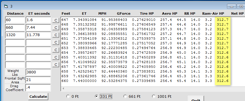

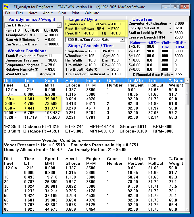

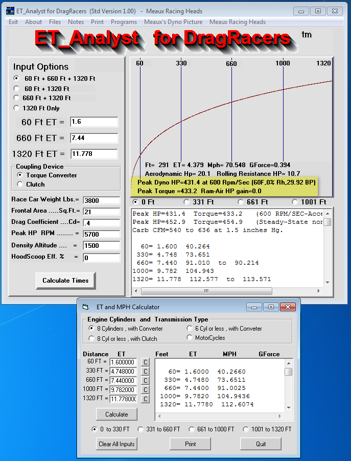

i'm showing the very same TQ -to- HP relationship as your Dyno sheet ( that is , within 1 HP and 1 TQ Lbs/Ft )Jdm1027 wrote:Is something wrong with my comb.
Motor made 574 hp and 572 tq on engine dyno. Motor is 418 sb mopar stroker motor. It is in a 72 challenger street car with stock rear suspension, 3.55 gear and a reworked converter from ptc roughly 3800 stall. A competition 727 from tci. Car weighs 3800 with me in it. The best time so far is 7:44 @91 mph in the 1/8. With a 26x10 slick on it. 60 ft times are 1.6. I am looking to try some caltracs on the rear but I just don't feel the mph matches the hp.
... its just your Dyno numbers are showing way too high
... about 100+ HP and Torque off .... seems to be a very happy Dyno ??
its showing a true 461.0 HP and 461.0 TQ output if at around 1500 Ft Density Altitude ( 1st Picture )
and its calculating out of the 461.0 HP/ 461.0 TQ ... you are actually using = 431.4 Peak HP and 433.2 Peak TQ down the Dragstrip ( not the same as RWHP ) ( 2nd Picture )
your actual real Rear Wheel HP as you cross 660 Feet 1/8th mile = 312.6
