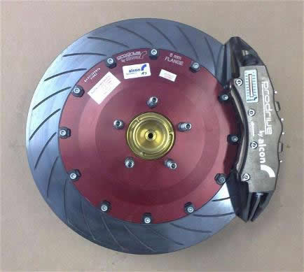

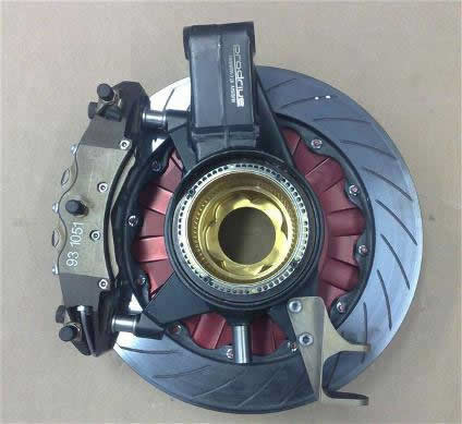

They talk about using a water-cooled disc brake design on racecars that was originally used for dynos.
You've also got water-cooled calipers. These are made by Alcon for WRC.

That is interesting, they are embracing a phase change of the coolant rather then fighting it, their design looks to have a fairly even coolant path, ie few hot spots. If it indeed it does work so well reaching temp to effect phase change, my guess they could also vary coolant operating pressure. Might also need to look for a cooler pad temp range. Bet a LSR car could use this help, where weight is often a plus, and stopping quickly without issue helps on making a quick return run when seeking a record.
