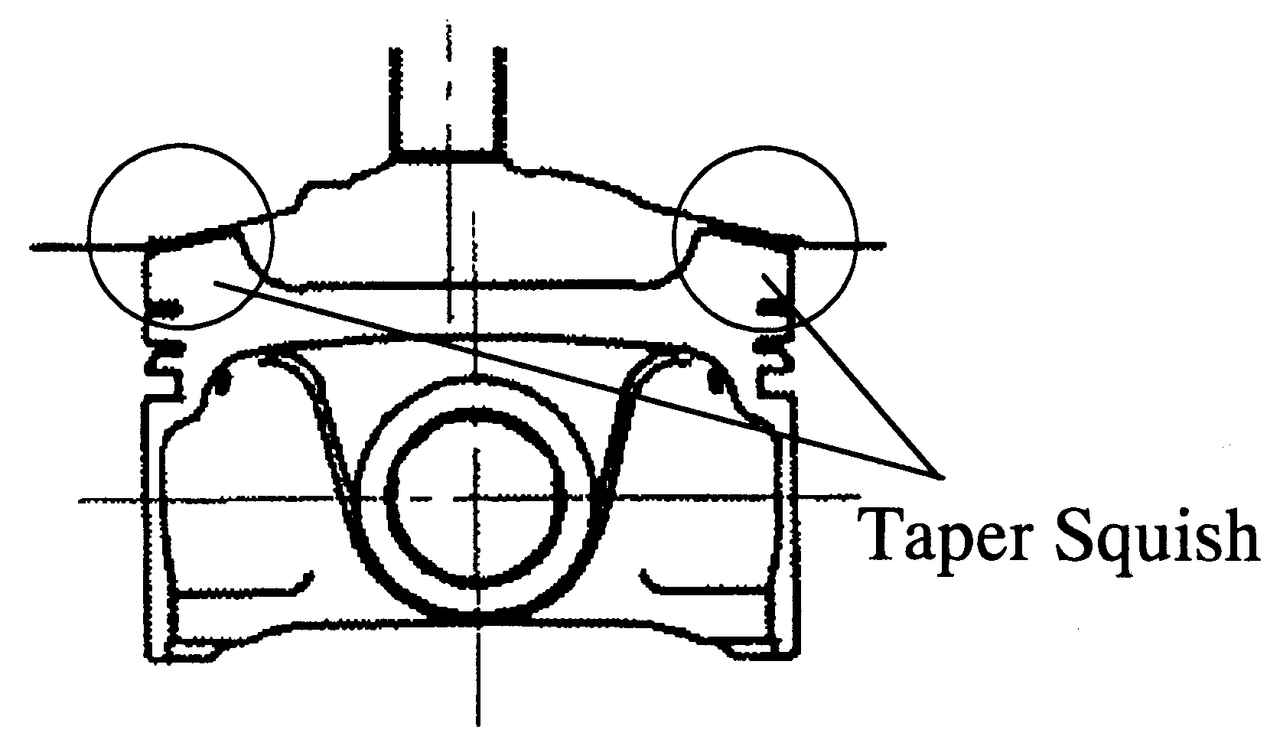

Is there any public-domain research or testing available on possible benefits of tapered quench pads for NA applications?
This would be where the quench area has a small divergent angle from the cylinder-side to the plug-side of the pad (a "mini wedge" rather than parallel surfaces between the piston top and the cylinder head). I presume it's similar to what I hear as "softening" the chamber for power-adder applications.

The Toyota paper discussed a directed squish, not a tapered quench if I'm reading that paper correctly. There is a lot of anecdotal evidence in the two stroke and Harley bike world, but nothing as far as track or dyno proof. It is something I would like to investigate one day.

There is a lot of conjecture regarding definitions and with regards to what others may have written I suppose it remains unclear at least to me. Regarding specifically the linked PDF. They are using squish to describe a parallel and angled piston to chamber shape and describing what sounds a lot like flame masking.
TAPER SQUISH COMBUSTION CHAMBER – The
squish area formed by the piston top and cylinder head
bottom surface has been tapered by being inclined along
the cylinder head combustion chamber wall (Fig. 10) .
This taper squish shape reduces the masking portion
around the intake valve when it is open, increasing intake
air volume (Fig. 11). Moreover, in the early stage of combustion,
this taper squish helps combustion pressure to
increase gradually and, at the latter part of combustion,
increases the burning velocity (Fig. 12), thereby en-hancing
anti-knock quality. It is inferred that the increase of
flow velocity to the squish area promotes the flame propagation
to the end of the squish area upon piston descent
(Fig. 13). Fig. 14 shows the benefits of the improved performance
in the prototype stage.
Really is worth reading and reviewing the various figures and will answer many of the questions posed here.
