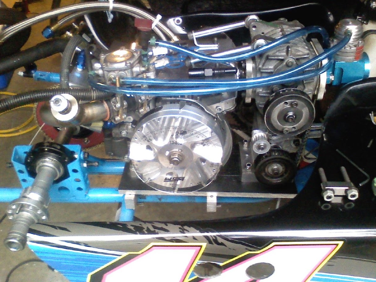

Just fooling around, seeing if I could pull it off.. Aisin Blower, Polaris 34mm Carb, home made stainless induction w/blowoff incase of a backfire.. and billet head with roller rockers.. high lift cam, billet rod, billet flywheel on a 200cc Honda Clone..
Actually ran decent.. idled like a little Alcohol Funny Car.. never could get rid of the surging at idle, but it did clean up as the RPM's got above 2000.
Thought TMS Joe might get a kick out of this..

It got a bit exciting when the blower made enough suction to make the flat slide Italian Methanol carb stick @ WOT...

Little Blower from Japan was originally on a 600cc mini car, drove it off the output shaft @ 15 P to 45 tooth ratio through a jackshaft.. built a "containment set of rods" in case the headbolts didn't hold.. and even utilized a vacuum fitting in the exhaust.
Spun it up to 8500 rpm a few times and after pulling the billet head off, and mailing it to Darin Morgan.. he told me the design of the head was junk in so many words.. put it back together and sold it.. was still a fun little project..
