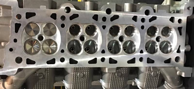

Post by 1972ho » Wed Jan 17, 2018 7:03 pm
Would this be the area you’re talking about
You do not have the required permissions to view the files attached to this post.

Post by midnightbluS10 » Thu Jan 18, 2018 3:23 am
What's the difference between the previously posted heads and these? Visually, they don't seem to be very different. I've seen plenty of people mention doing pocket work on 4v modular heads. If there's "no pocket", what are they referring to?

Post by 1972ho » Thu Jan 18, 2018 10:46 am
The bowls in these heads have already been ported and cleveland bowls have not that’s why they look a little different.
