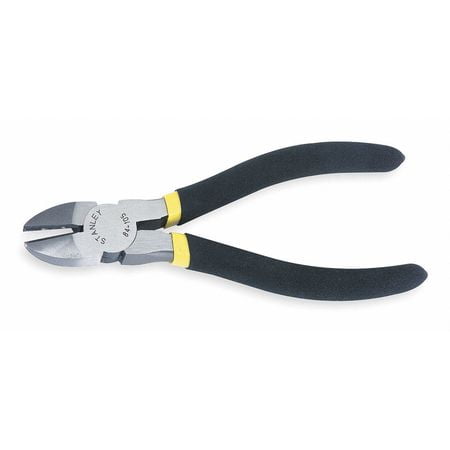

You can lengthen the idle speed screw spring with a pair of diagonal wire cutters. Pinch between the coils so the tapered jaws spread the coils. Work around the spring so the ends stay relatively square to each other.
If that Pontiac has original heads and compression ratio it might be happier with 30-32 degrees total .... and with today's gas not until 4000+ RPM. If you can get to a distributor machine shoot for 18 initial, start advance 1200, 26-28 at 3000, 32 at 4000, 34 at 6000. The late 60s Pontiac heads with machined combustion chambers don't need (or want) as much timing as Chevy heads.

Tuner wrote: Sun Feb 11, 2018 7:03 pm You can lengthen the idle speed screw spring with a pair of diagonal wire cutters. Pinch between the coils so the tapered jaws spread the coils. Work around the spring so the ends stay relatively square to each other.
An easy and logical fix...and should have been obvious, but in years of carb work, I have never had to do that...thanks!
