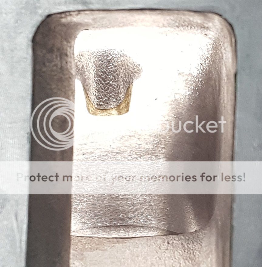

After some help and some deleting of postings I can return to posting. Expect old threads to be useless. Which sucks because I constantly find excellent old threads on this board. After seeing the valve surface treatment done by cnc I took a useless Chevy 1.94" valve and did a bit of burr work on it. Interested in some input with this trick. Thanks, Charlie

If one considers the boundary layer flow factor of air the roughing of the backside of any valve for improved air flow seems a bit suspect to me and I think the actual seat and throats improvements will yield more proof of better flow than trying to change direction and flow of air by lightly roughing a surface. If these methods with careful calibrated and confirmed flow testing and power improvement show meaningful or real usable improvements then I am all eyes and ears! Guess I still got a lot of Missouri in me!

Look familiar, our little 347 SBF in the 2017 EMC. From the intake carb flange to the bowl it was that texture, then transitioning to the 100 grit sand roll before the seat. I've been doing that on some heads for years. Anyone remember the Americas Cup boats, and when they put a texture on the bottom of the boat, smoked all the competition and it got outlawed. The texture stored water in the groves, water on water had low friction or drag.
