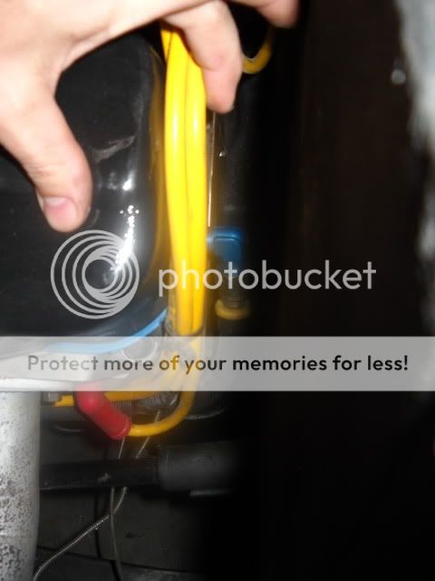

I've been searching around, looks like you can just tap the back of the head
This is a BBC, I'm not sure about the sbc. I am thinking 8an minimum
If we keep the valve springs dry though will this have any repercussions on an engine that is running 30min to an hour at a time?
I really think on something like a road course engine it would be beneficial to have them in the front and back

Don't supose you got a pic? I only read bout the oil dumpng and would appreciate all the info on where and how big a hole your talking. I'll see wht info I can find but this is the 1st I've herd of it and that might be the eiaser/better route for my use.
Thx for the pics ctk30, I was thinking the same 8an and maybe alum line, like I saw on a helicopter motor.
