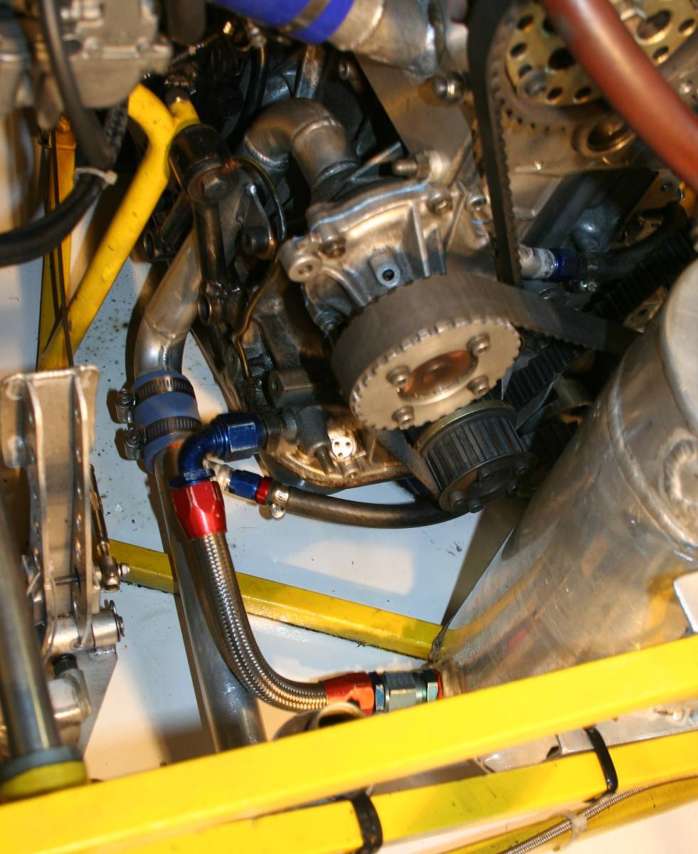

Perhaps a bit on-topic the dry-sump system I use on my old racing car might be of a little interest as it's as simple as I can make it.
It's a Suzuki G13B twin-cam 1.3 litre in a small sports car in Australia. (somewhat bent & sad right now but will be repaired)
The entire system has just three oil hoses, one from the tank to the engine. I use the factory oil pump on the front of the crank as it works fine.
Then from the front of the sump there's another oil hose that goes to the scavenge pump that's tucked away under everything so you can't see it. Then from the scavenge pump the last hose that dumps the oil back into the tank. (The tank return isn't right, it was built that way for the old system and I haven't changed it yet. I don't like the 90° turn into the tank)
The oil cooler is from a Subaru WRX and it's a water-to-oil heat exchanger that sandwiches between the block and oil filter. I welded on a small fitting onto the end of the water pump to get a cool water source for the heat exchanger and it returns the water into the water pipe that goes into the water pump inlet, it can be seen in the first photo. The benefit of the heat exchanger is that it warms the oil much faster than a conventional air cooler and also helps keep the temperature at a more stable level.
That's as light and as simple as I can make it.
The tank is quite large for the engine but it gives plenty of room for the oil to centrifuge around to de-aerate itself. I also carry a bit more oil than I really should (~4 litres) but I inadvertently found out with that much oil in it, if the scavenge pump fails (which the drive to it did once) the engine naturally fills with oil but with the height of everything it's just enough to keep pumping a bit back into the tank and drip-feed the engine.

Neat. What pump is that?Billzilla wrote:What can often help is to pass the oil through an oil cooler on the way back to the tank as that helps the oil lump back into a more homogeneous mass.MadBill wrote:Sounds like we're screwed regardless! Maybe if we use a dry sump with the bypass routed externally back into the return line to the tank, through an air separator?
I now run a big-arse low-pressure oil light .......
I see that the pump belt is fairly close to the block surface. One of the problems on a SBC is that the belt is pretty far away and in my car that will make the belt/pulley hit the front crossmember that has to be notched for that reason.
Re: Please school me on dry sump systems
We made it ourselves out of a big chunk of alloy. It uses two gears from a Holden 308 oil pump - they're similar in many ways to a SBC though I'm not sure if the SBC has an external oil pump.Belgian1979 wrote:Neat. What pump is that?
