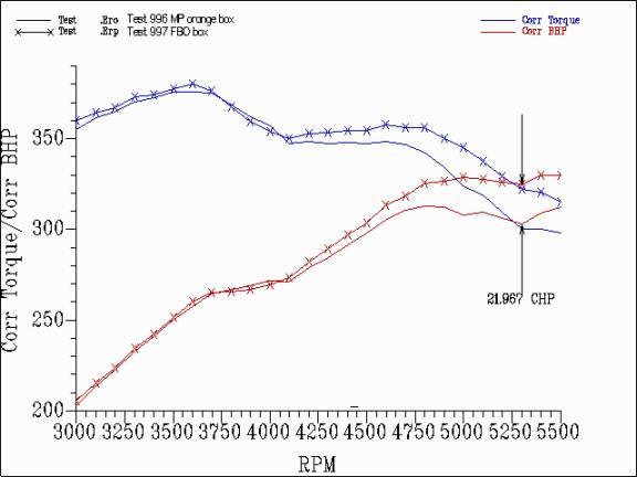

A seperate problem with some Mopar ignition boxes is timing retard with increasing RPM. Like 6 degrees retard in a 4000 RPM increase. (35 total @ 1200 29 total @ 5000 with a locked out distributor, MP Orange Box, FBO coil ignition.) You can imagine what that could do to the power. I dyno tested a Mopar 383 RB, the owner had a Mopar Performance Orange box, changing the ignition box only, made a 20 chp difference at 5000+ RPM.
Here is the graph;
http://www.revsearch.com/ignitiontest.jpg
There was not really an audible difference in the way the engine ran.
The coil was the FBO piece.
The intake was a cast iron dual plane that did not lend itself to easy fuel distribution mods, the cast iron exhaust manifolds probably didn't help either.
There should not have been dropped sparks with the FBO coil/Orange box combo until 5400 RPM so the problem was probably the RPM retard "feature" of the MP Orange box.
At about $2 per hp the FBO ignition box was a pretty good investment.

We had a similar Box Retard problem,using some Ford box.
I forget the exact amount,but it was a LOT more
than 6 degrees in 4000 rpm.
Switching to an MSD box solved that problem.
putztastics wrote:A seperate problem with some Mopar ignition boxes is timing retard with increasing RPM. Like 6 degrees retard in a 4000 RPM increase. (35 total @ 1200 29 total @ 5000 with a locked out distributor, MP Orange Box, FBO coil ignition.) You can imagine what that could do to the power. I dyno tested a Mopar 383 RB, the owner had a Mopar Performance Orange box, changing the ignition box only, made a 20 chp difference at 5000+ RPM.
