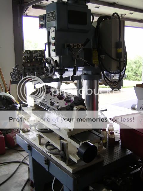

Postby SMITHBERGRACING » Mon Dec 26, 2011 1:48 pm
Here is the one I have which is a Variable Speed model (has a VFD) TCMV-25. It's a newer model and has done me pretty well over the years. Looking to purchase a mill in the near future and buy the CP Motorworks Fixture for an added option to what I do for valve jobs and head surfacing. I really like the variable speed to change on the fly!

SMITHBERGRACING wrote:Image
My friends shop has that same air float table on a Winona, I drool over it every time I am there. He said it came from a TCM he used to work on.
As long as the machine is good and the pilots are carbide, I don't foresee a problem using a TCM for 3D seat work unless I am missing something?

Postby SMITHBERGRACING » Tue Dec 27, 2011 6:54 am
I use the 3D tooling on mine with either tool steel or carbide pilots. I really like the VFD option cause you can change speeds on the fly especially if you start to get a little chatter during the cut. Not sure how that works on the model you are getting?

Postby SMITHBERGRACING » Tue Dec 27, 2011 9:03 am
Yep I run 60 RPM on smaller valve stuff, a little slower on bigger valves. I've seen guys cut at 125 RPM but I don't know how they do it? #-o
I still get a nice finish that is concentric, all that really matters.
